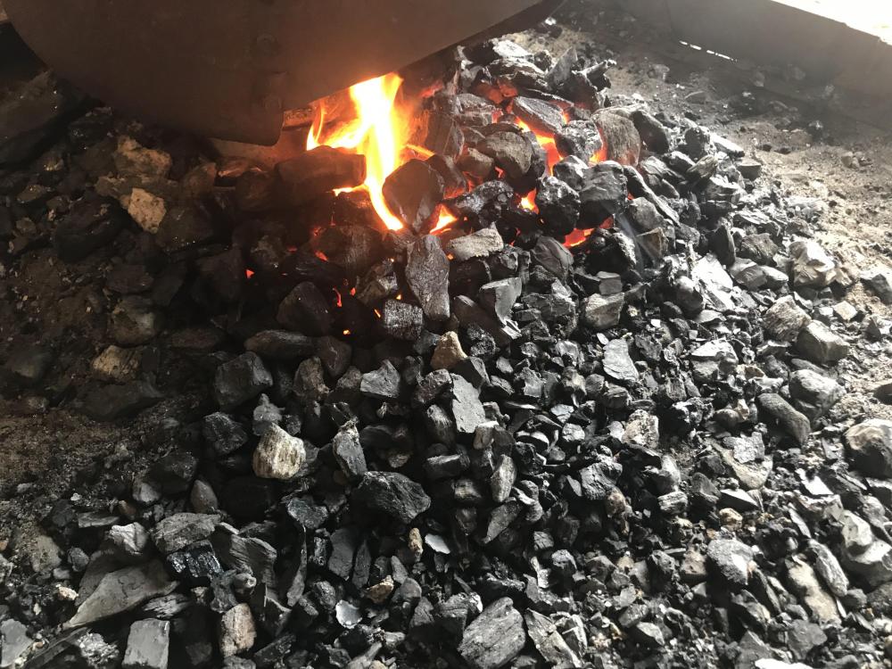

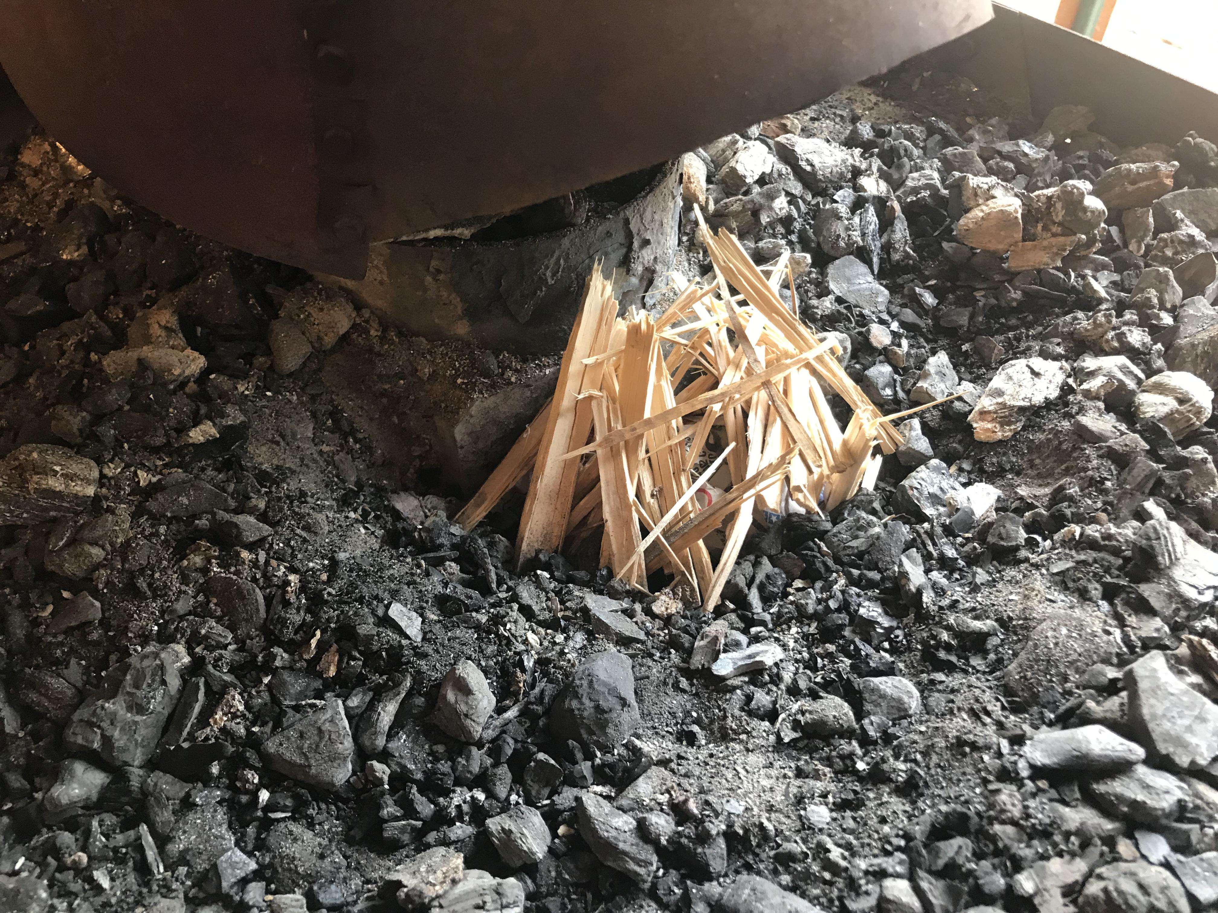

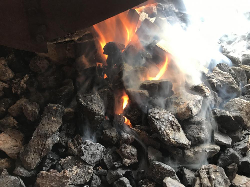

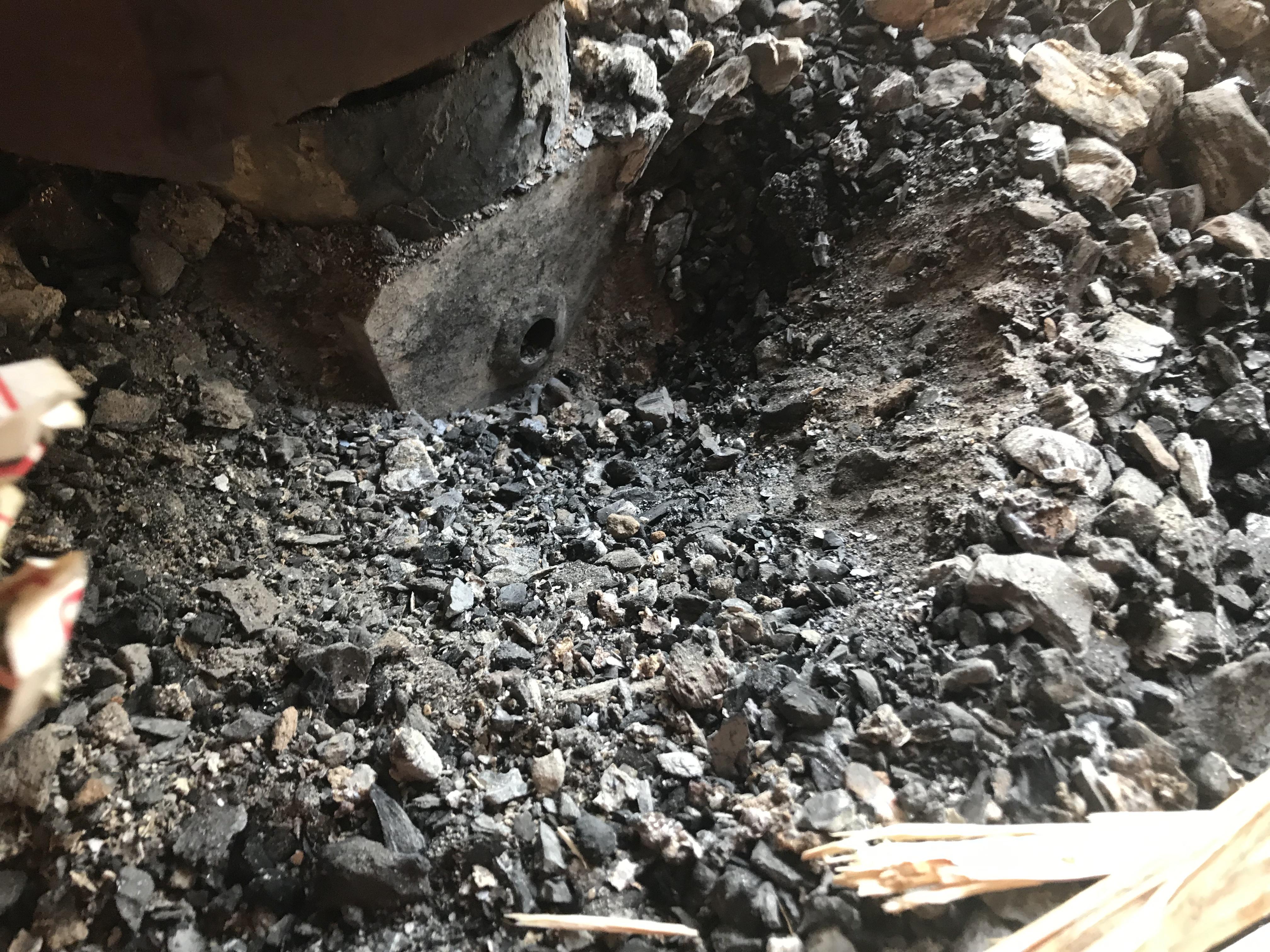

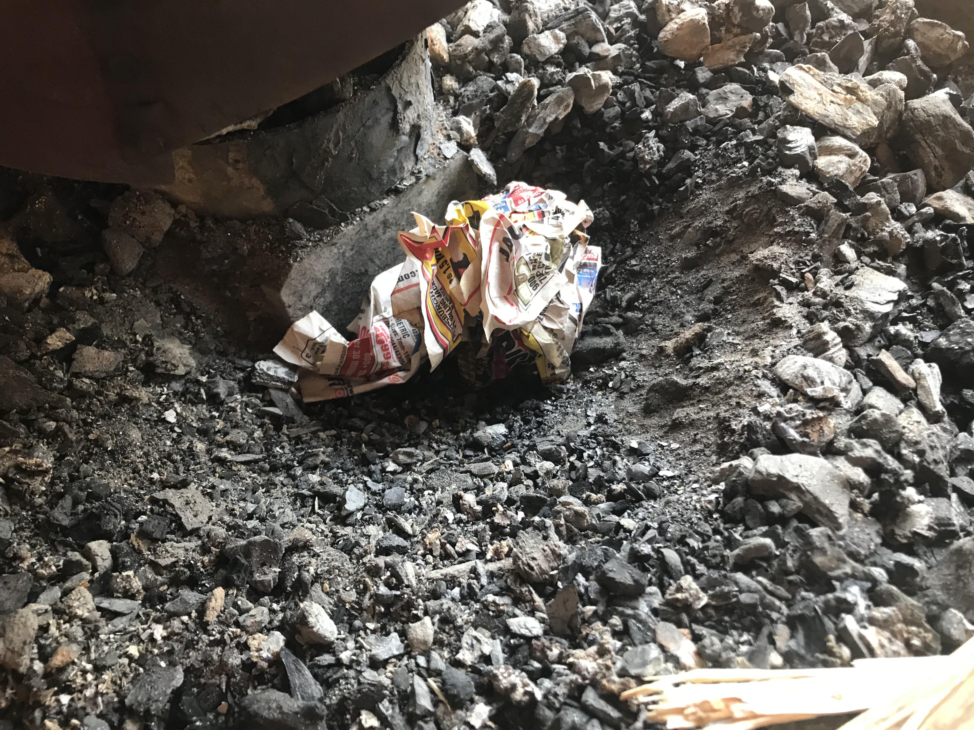

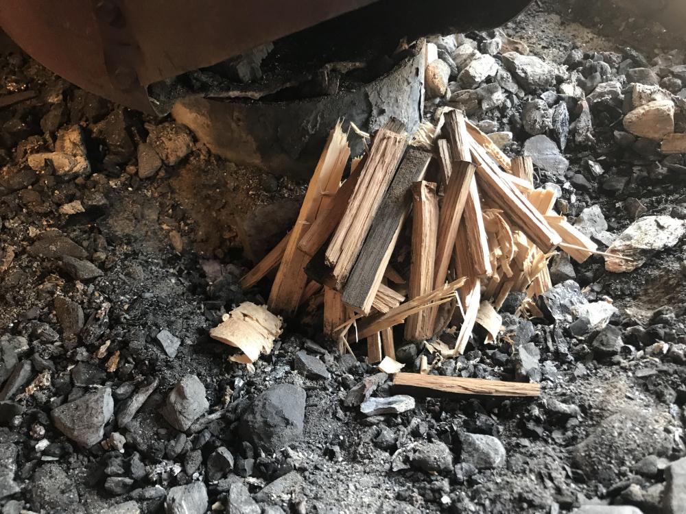

That said, regarding the issue of an oxidizing fire, this is less of a problem than it might appear. As long as your fire is sufficiently deep and you have balanced the strength of the blast with the volume of the fire, you will still have a neutral center and a reducing top layer, the same as with any other fire. Anthracite's inability to "idle" simply means that the air necessary to maintain the fire has to be injected mechanically rather than drawn in by the natural draft of the fire. In other words, it doesn't change the fuel:air ratio.

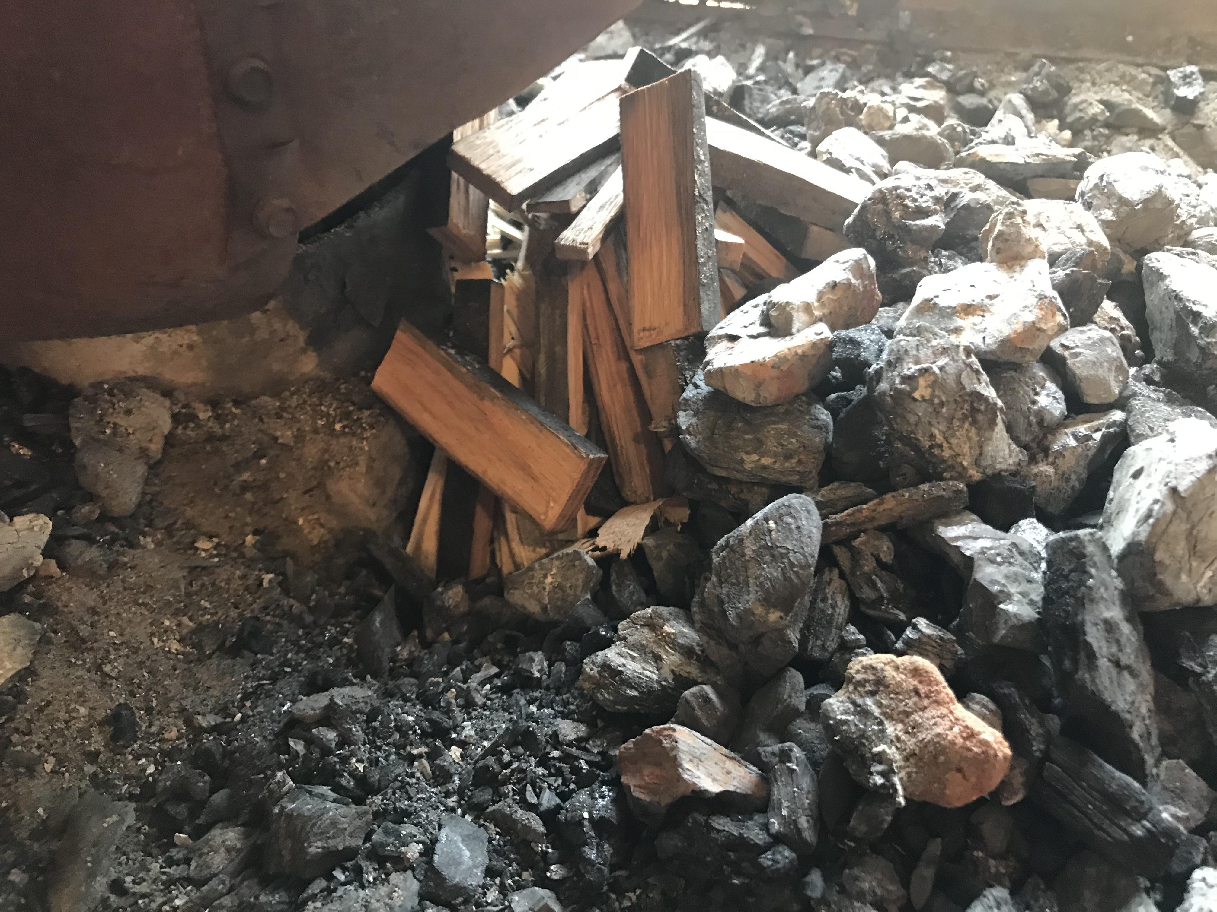

A sequence of photos showing the building of an anthracite fire.
Space cleared in front of the tuyere.
A ball of newspaper.
A handful of softwood slivers.
Fine hardwood kindling.
Chunky hardwood kindling and the first bits of coal around the kindling pile.
Kindling lit and first bits of coal on top.
Fire well-established and coal starting to burn nicely.

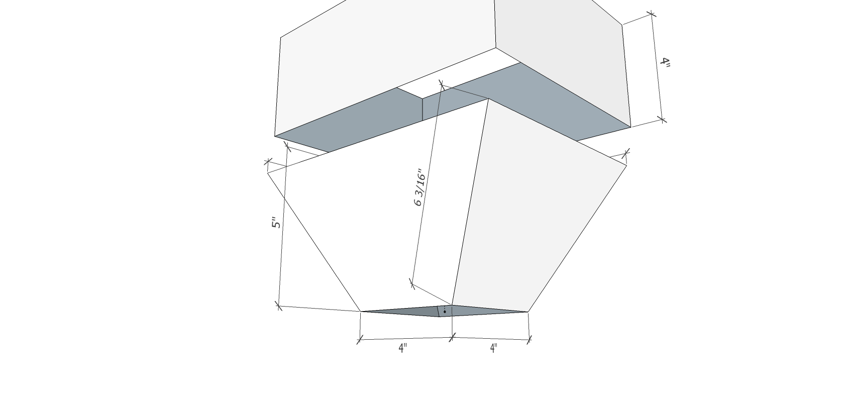

Great read, but were can I find the "ideal size" pot size for my only local sourced TSC nut
  • Anthracite
  • 40 lb.
. Plus optimal BTU blower requirements.
I want to get this build right the first Time. So many conflicting options in here, I'm not sure what to do?
PLEASE direct me towards any useful information on this.  i'll attach a 3d drawling I put together per info on u tube... ?
it seems too deep to me but hey what do I know.....  That why I am here!
Thanks & Peace Out!

As I recall some TSC's don't carry coal during the summers and so you may need to stock up near the end of the season.  Might talk with the manager about buying what's left at the end of the season at a substantial discount... (I've made such deals with stores before; they get to clean out inventory *fast*; I get stuff I want cheap!)
"Optimum" is as much a function of what kind of work you're doing as it is of the kind of fuel you're using. Take some time to read over the posts in the Solid Fuel Forges section, and proceed accordingly.
One good option for you would be to start with a JABOD forge and use that to learn what size firepot will be best for your work.
oh believe me I have read up in here as much as I can, yes I've read about JABOD.  I just want someone with real world experience to tell me , yes looks good start there or no way dude your a xxxx xxxx do this...  I built a small brick ribbon burner now I'm looking for what I need to get to larger pieces of mainly decorative dressings on my silo house. . I have stair railings & balcony's, door knockers & large cedar wrought iron door (i'v already built but needs dressing)  all the way down to drawer pulls, shelf brackets & such.  See this is what I'm doing for my retirement. This in my fun time to enjoy life.  Peace Out!
