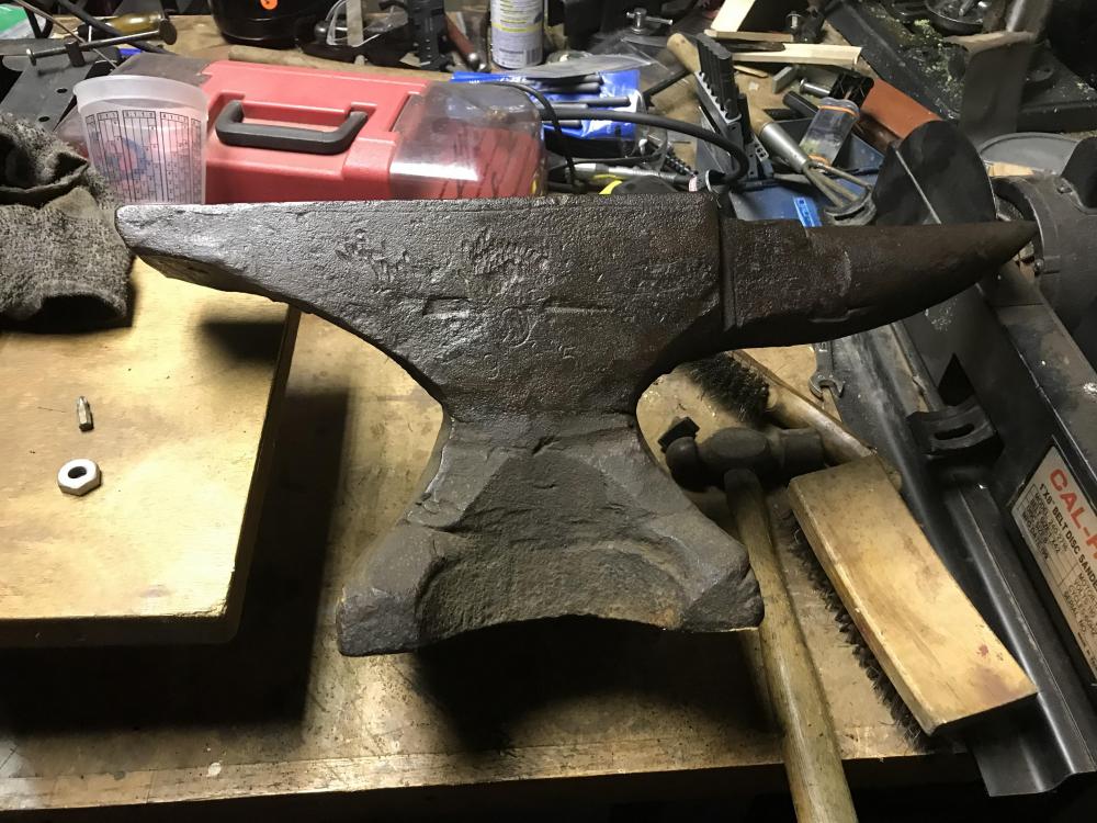

Ocelot Posted December 3, 2012 Share Posted December 3, 2012 Hi, I just picked up my first anvil. It weighs 136 lbs and appears to be in good condition. No visible markings. Can anyone ID this anvil? Thank You! Quote Link to comment Share on other sites More sharing options...
ThomasPowers Posted December 3, 2012 Share Posted December 3, 2012 What does it look like on the bottom? Quote Link to comment Share on other sites More sharing options...
Bentiron1946 Posted December 3, 2012 Share Posted December 3, 2012 Put a wire brush on a 4" hand held grinder and clean the surface off and you be able to see more of the original surface that may contain markings. DO NOT use an abrasive disk on any surface of the anvil, only a wire brush, you want to clean it not destroy it. Looks like a very fine anvil. Congratulations on acquiring this fine tool! Quote Link to comment Share on other sites More sharing options...
Ocelot Posted December 3, 2012 Author Share Posted December 3, 2012 Thank you. I found a gem for sure. Paid 10 bucks for it at a local metal place looking to get rid of it! Quote Link to comment Share on other sites More sharing options...
Ocelot Posted December 4, 2012 Author Share Posted December 4, 2012 What does it look like on the bottom? Quote Link to comment Share on other sites More sharing options...
Timothy Miller Posted December 4, 2012 Share Posted December 4, 2012 Its most likely a Hay Budden . Quote Link to comment Share on other sites More sharing options...
otisdog Posted December 4, 2012 Share Posted December 4, 2012 A $ 10 dollar anvil! Wow! Looks nice... Quote Link to comment Share on other sites More sharing options...
ThomasPowers Posted December 4, 2012 Share Posted December 4, 2012 Is their a faint trace of a raised lip along the outside of the bottom? If so it's the remnant of the Hay Budden Hourglass depression; but often worn down to flat in older ones. Quote Link to comment Share on other sites More sharing options...
Frank Turley Posted December 4, 2012 Share Posted December 4, 2012 Hey bud! You got a deal. Most often, a Hay Budden will have a single number stamped in the waist, under the horn, next to the handling hole. Quote Link to comment Share on other sites More sharing options...
pkrankow Posted December 4, 2012 Share Posted December 4, 2012 After cleaning with a wire brush you may find the feet under the horn stamped with a serial number that can identify the age of the anvil. My first thought was Trenton because the line where the tool steel face is welded is visible, however that is not a solid indication. Trenton and Hay Budden are two very good brands! Both companies did number the anvils in a similar area, the weight on one foot the serial number on the other, and the markings were opposite location between the two brands. There also may be a brand marking on the side. Wire brush, some oil or wax and it will shine...or just use it the way it is and it will clean up quite a bit from use. Phil Quote Link to comment Share on other sites More sharing options...
Frosty Posted December 5, 2012 Share Posted December 5, 2012 Super score! Congratulations on saving a poor homeless anvil from becoming part of an economy car. Use her in good health. Frosty The Lucky. Quote Link to comment Share on other sites More sharing options...
Ocelot Posted December 5, 2012 Author Share Posted December 5, 2012 I found a serial number when I cleaned it up with a wire wheel along with a single K. Turned out beautiful after about an hour of work Quote Link to comment Share on other sites More sharing options...
