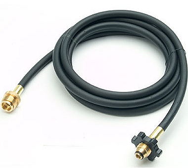

Johnny40 Posted July 10, 2015 Share Posted July 10, 2015 Hi, im a beginner blacksmith, and i wanted to know if it was possible to use a simple 1lb torch head with a hose directly in a 20lb propane tank to heat up a small homemade paint container forge. If not, wich torch and or material should i get to heat it up to the right temperature. Keep in mind that i am a student with really low budget.Torch that i have : http://ecx.images-amazon.com/images/I/31cgyK4N--L._SX466_.jpgHose that i will get : http://www.devardiglass.com/hose.JPGSorry if i made grammar mistake, im french. Quote Link to comment Share on other sites More sharing options...

Johnny40 Posted July 11, 2015 Author Share Posted July 11, 2015 i got a hose for my 20lb tank today but i was wondering if i need to also get a regulator and wich torch i should use. I tried to find some detailed video or plan on how to make a propane burner but i can't find any. Quote Link to comment Share on other sites More sharing options...
LastRonin Posted July 11, 2015 Share Posted July 11, 2015 (edited) i got a hose for my 20lb tank today but i was wondering if i need to also get a regulator and wich torch i should use. I tried to find some detailed video or plan on how to make a propane burner but i can't find any. yes you need a good quality adjustable regulator, 0-30psi is typical. And did you search t-burner on here?A 1/2" t-burner would probably work fine for your paint can forge, especially if you move the burner inlet to the middle.BTW, the t-burner was invented by the fellow who posted just above you, Frosty. Edited July 11, 2015 by LastRonin Quote Link to comment Share on other sites More sharing options...

Frosty Posted July 12, 2015 Share Posted July 12, 2015 Johnny: I had a more thorough reply Forbidden yesterday and forgot to save it first. <sigh>Search under gas forges, it'll turn up, I didn't post it as plans or instructions just a concept sketch for an old style.Yesterday I suggested using ceramic blanket refractory to line your forge. Place the burner in the center aimed at an angle rather than directly at the far side. Find a professional plumber's torch like you'd see working on an industrial site, etc.You can buy a proper propane regulator off the shelf in Alaska for around $25.00 at the Propane distribution show room. Amerigas by name in Wasilla Ak.I've been working on a newer T burner and MUCH easier construction method but haven't gotten it tweaked nor drawn up. Soon though. Teenylittlemetalguy has making 1/2" T burners honed to a fine science, maybe he has some pics or drawings.I suppose if you wanted to waste a huge amount of time you could sift through my posts, I've described making the current style a few times. I'd just do it again but I'm a TBI survivor and have enough trouble staying on one track so if I start describing how to make the old version I'll get lost and mix it up with the newer one. I know that sounds evasive but it's how my brain works now.On the other hand if you get stuck on something I can trouble shoot without confusing myself.Frosty The Lucky. Quote Link to comment Share on other sites More sharing options...
Johnny40 Posted July 13, 2015 Author Share Posted July 13, 2015 could i just get this torch with a regulator ? http://www.harborfreight.com/propane-torch-91033.html Quote Link to comment Share on other sites More sharing options...
Frosty Posted July 13, 2015 Share Posted July 13, 2015 could i just get this torch with a regulator ? http://www.harborfreight.com/propane-torch-91033.html That particular torch is a weed burner and will put too much oxygen in the forge so your work will scale up quickly and not get hot enough. This would be a bad choice.I'm not finding what I'm thinking of and I just spent a good hour looking at pics online. About the closest I've seen was the Bernzomatic jumbo propane torch but I just not seeing what I was thinking of.I've been making the things for years and not shopping to buy. I'm probably the wrong guy to be suggesting what to buy. I can spot bad ones but I don't know where the pro models are.Frosty The Lucky. Quote Link to comment Share on other sites More sharing options...
